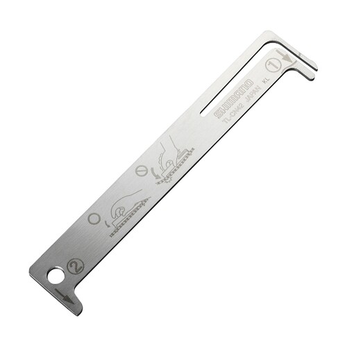

FWIW: I use a Pedro’s Chain Checker to measure chain elongation. It measures pin-bushing wear and not roller wear. Shimano makes one somewhat similar, as do a few others.
