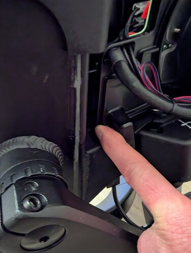

In case anybody reads this thread and has the same issue… Support still has not responded but I found the source of the noise. I really can’t describe it well but have added a photo.
I took the non-drive side cover off. Behind one of the internal covers, there are two sheathed cables that run beside each other. There is also a plastic lip that was separating the two cables. The cable closest to the non-drive side was vibrating with the ratchet noise. If I push it to the other side of the plastic lip, it resolves the ratchet noise. I suspect that the plastic lip is to hold both cables toward the drive side, but for some reason, my cables were split either side of the lip.
Hard to explain, I know. In the picture, I am pointing to the cover that the two cables and plastic lip are behind. I couldn’t see them, only feel them. I hope this helps somebody else in the future.
