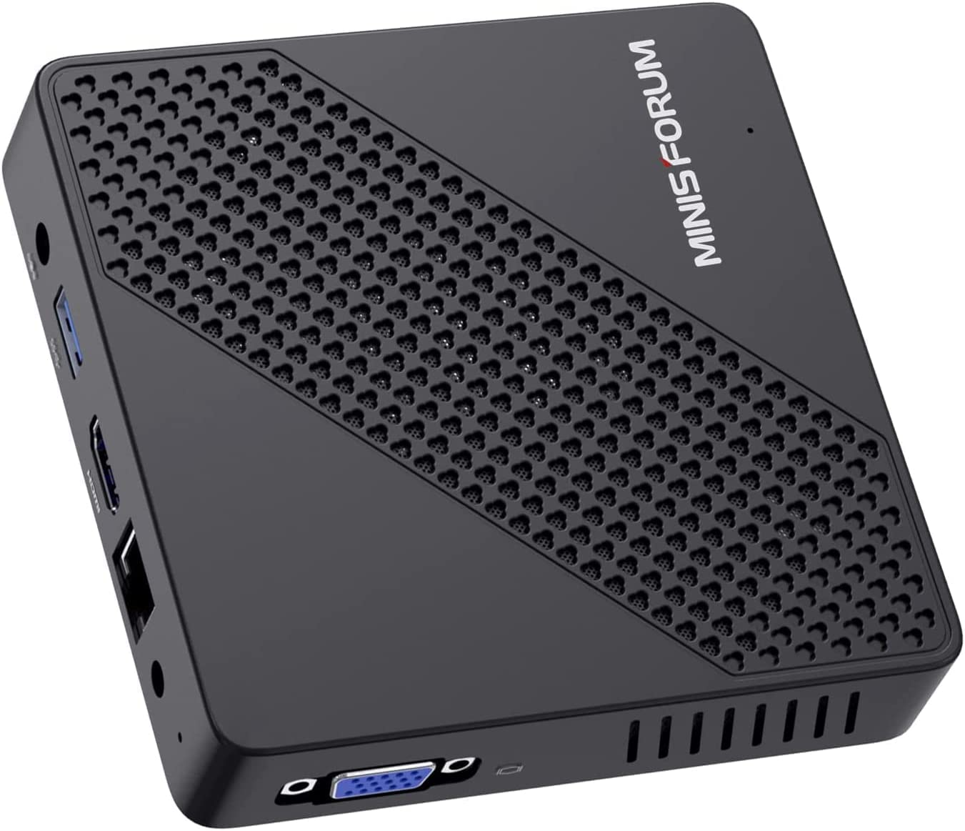

IDK, but there are some inexpensive Windows 10 mini PCs that could well work . Here’s one:

Hi, I was looking for something similar and I thought of a mini-PC like the one in the link
I believe there is no problem for Systm but, what about RGT? Any experience anyone?
