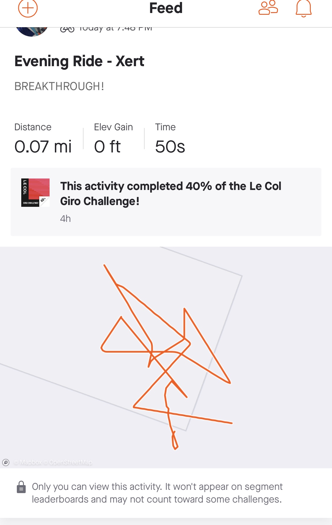

Yes thanks, I agree best to keep all one source so I am going to continue to dual record, my setup is iPad with suf and H3, then head unit recording from crank.
I don’t upload the suf workout to Strava, just the one from head unit automatically goes to Strava which in turn syncs with xert. Only downside is you don’t get any of the nice graphics and info from suf in strava, wahoo bolt just sends time and power which is all xert needs
Xert actually only uses the Elapsed time which in this case was 1hr, but Strava just shows moving time.
