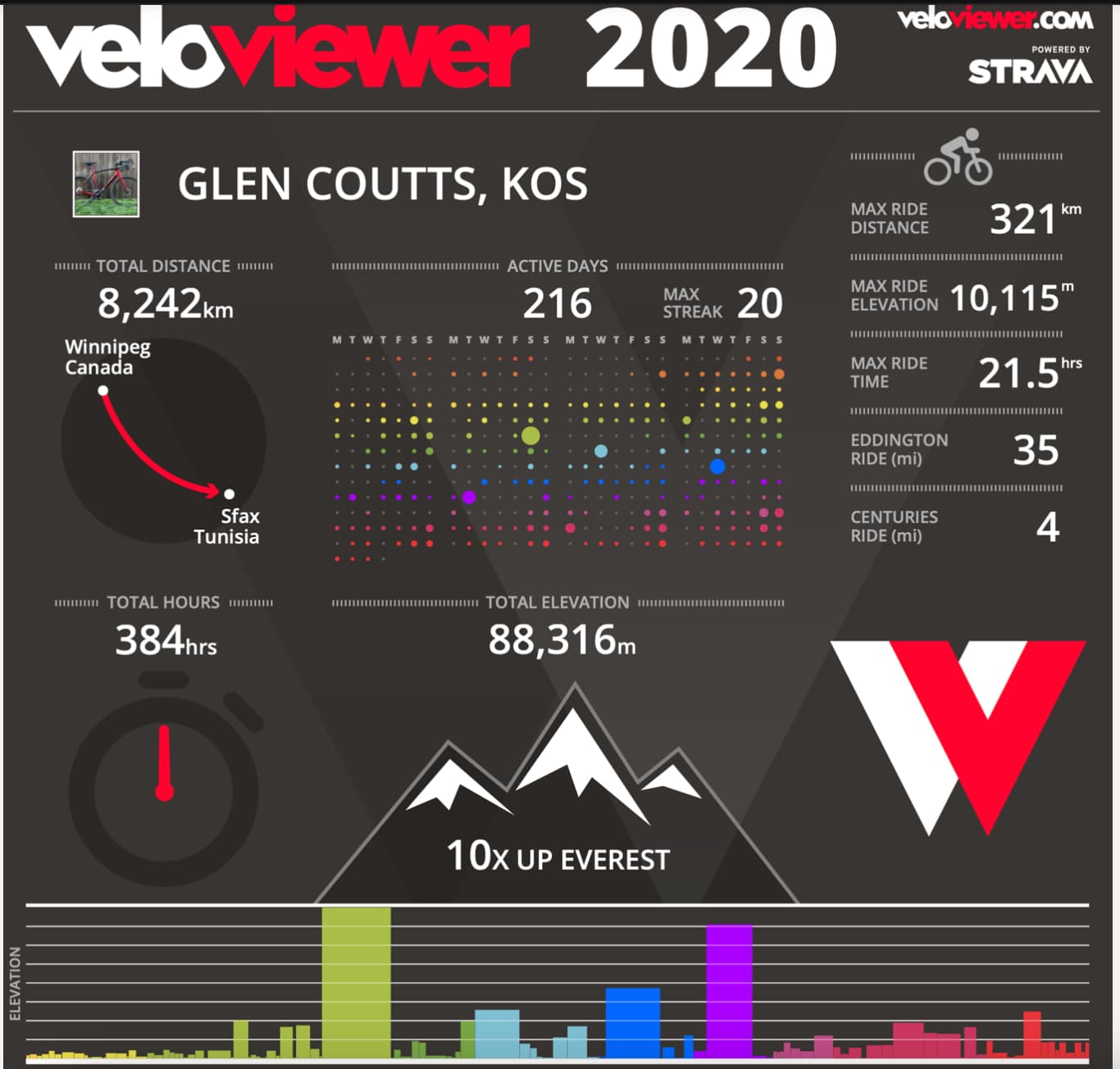

Veloviewer, for example, provides a separation of virtual elevation from irl elevation in its infographic. Here is mine from 2020 with virtual rides included and one with them excluded. It’s just a little ticky box where it asks to include virtual rides or not.
I am personally not at all invested in whether SYSTM decides to report the elevation on its data files or not ( and I get why they don’t cuz its NOT a sim, at least not until they implement the Tours Channel
) B UT imho, if it did, and THIS is what motivates people to ride more, “climb” more, get more active etc I would TOTALLY endorse it.
