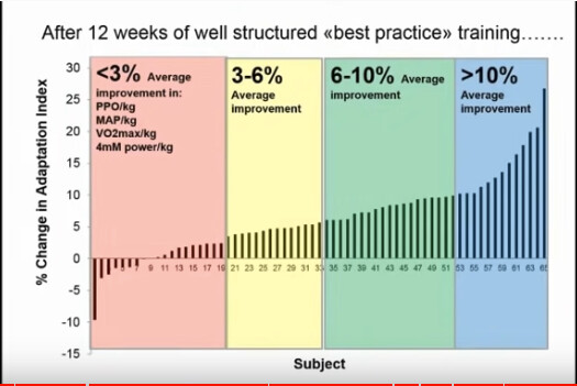

Stephen Seiler gave a talk about training methodologies. The talk is still relevant:
The interesting part for this discussion starts at 28:08.
This was a study using competitive, but non-elite cyclists who trained with three different periodization strategies, but were exposed to the same volume and intensity of training. There was no statistically significant difference between the approaches, but if you look at the individual results. You see a wide variety of success:
What I take from this is that training plans have to be individualized because the response to training is highly variable. People who say the training plans work, and look at my fantastic results, may fall in the rightmost category. Others could fall elsewhere.
The issue is, of course, that most people cannot afford to have the training individualized for them. They cannot afford to continually have new plans drawn up for them, and pay for weekly consultations to adapt the plans to changing circumstances, and revise the plan as it is seen how they respond to the training. This is what Xert is trying to do with its Adaptive Training Strategy. Of course, it is an open issue whether that works.
This is why I suspect that the coaches cannot answer the question because it is a classic “It depends”. Nonetheless, it would be interesting to understand the logic behind how the plans are put together

I’m not sure @Heretic’s chart implies that more customization would help a lot (except maybe manipulating volume and progression more dynamically—which requires at least weekly feedback from your coach and is what you get when your hire one). My big take-away from the chart is that it illustrates the high individual variation in the dose-response relationship to training. Because the study’s subjects were competitive cyclists, the real dose-response relationship is likely more extreme (because competitive cyclists are partly self selected to better dose-response—because that makes it much easier to get competitive). Combined with individual variation in robustness to training (how much you can do without getting injured or sick), I suspect that some people’s results will always be better than others, no matter how customized the plan.
Just judging from the responses on the forum, different individuals respond differently to the same % of their individual 4DP component. For example, different amounts of fatigue might result at the same MAP percentage depending on their individual ability to reuse lactate, or carry away metabolic products.
You are years ahead of me because of your experience in being able to tweak the plans. I do agree that the plans serve as a good starting point, but most of us do not have your knowledge and understanding.
I suspect that customization would help because there were people who had a negative response to the training stimulus. Now there are medical conditions where this is true, but this should not be the case for the cyclists studied.
Also we know that people have different abilities (sprinting, endurance, clearing metabolic products at different rates, etc.) so I suspect that some of the varying response has to do with tailoring the training to their abilities. Everybody in the study basically had the same training.
Of course, as you say, we cannot know for sure, but that is a problem with all sports science given our current state of knowledge.
