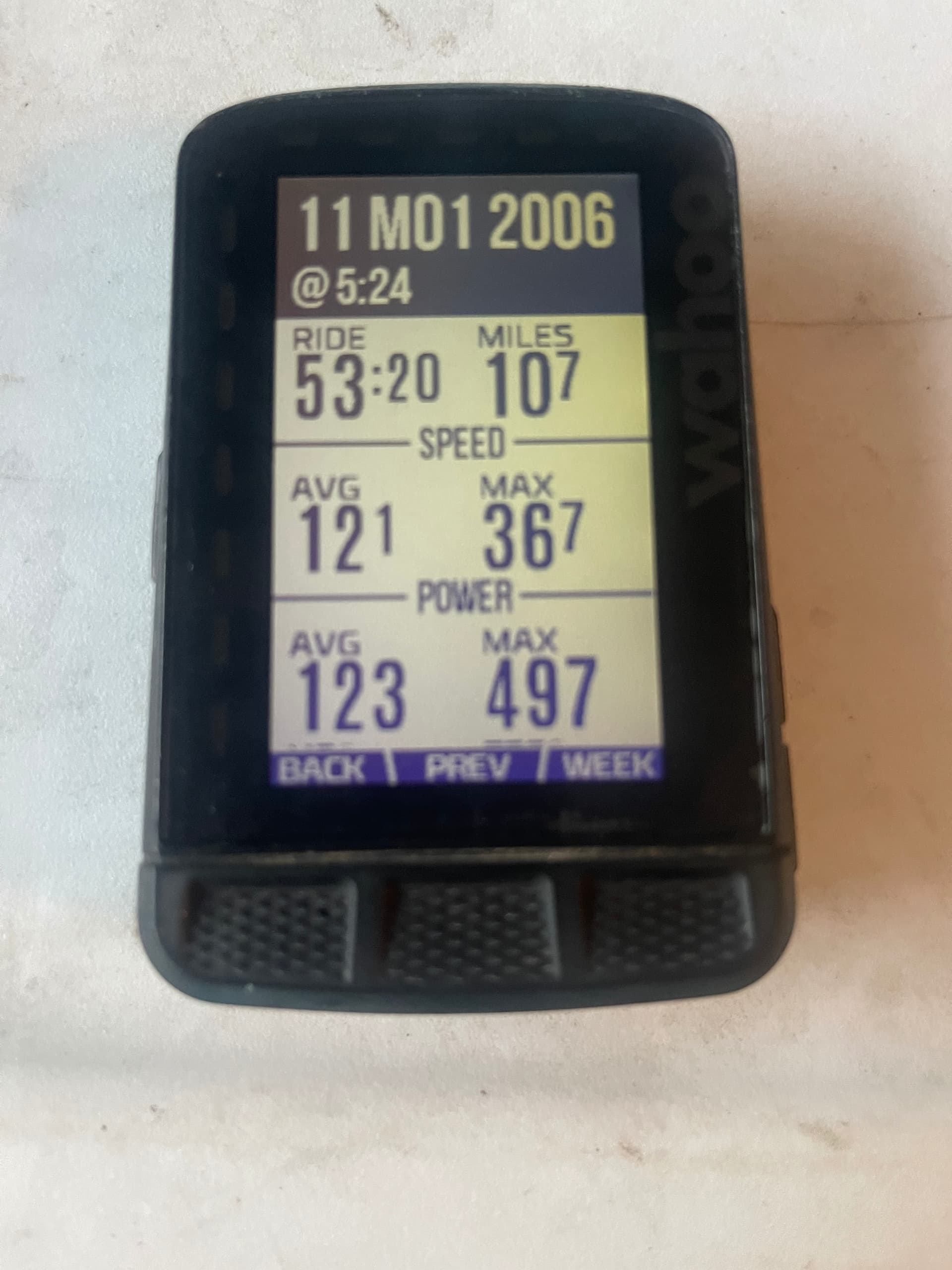

Today, Aug/27/2025, my roam had the wrong time again(1hr earlier than my timezone), it recorded my ride, but the date it used was Jan/11/2006.
Wrong again!
What happened? Did something else break in your service?
