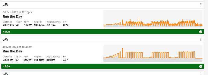

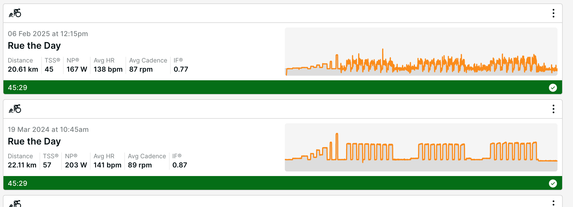

I’d guess you are seeing power fluctuations because you have not selected “ERG mode power smoothing” either in the SYSTM settings (available once you start a workout) or on the Wahoo App (available under the Kickr Core settings). It is 100% normal for there to be power variations with slight cadence variances and varying pedalling smoothness and choosing the “power smoothing” option in SYSTM and/or the Wahoo App won’t change that, but, what it will change is the graph you are looking at so it will become pancake flat while riding and/or afterwards when you review it. Some people, like me, prefer the flatter graphs in both instances (even though I am well aware that my pedalling is FAR from smooth :joy:) and some people absolutely hate it and will tell you to NEVER use the power smoothing feature.
Here’s a summary view of the same ride with power smoothing off and with it on
