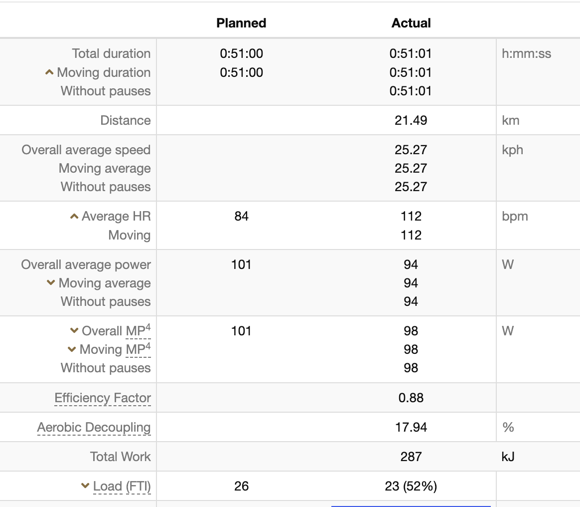

Attaching the results, and as you will see they donât correspond with what I was actually doing, that is to say, following the power exactly.

If itâs as simple as the trainer not seeming to hold a target power, it could be a couple of things. If itâs just a few watts, it could just be about how the trainer comes up to the target and responds to small changes in cadence. The graphs that show power and cadence as perfectly uniform are usually smoothed to some degree, in reality power jumps around because of tiny (and very normal) between pedal strokes and even how/when the power meter takes a measurement. It gets exacerbated if you use power match â ie power meter to measure, but trainer set the target â because of latency in the true-up.
The good news is the differences in wattage youâre showing in your second reply â 98 vs 101 â really donât matter. Even for a longer ride where the tss differences add up to be more substantial, it still doesnât matter. Eg endurance: If you properly rode endurance paceâa pace you can sustain w/out finishing that much more tired than when you startedâat the duration you wanted, then you did the workout right. +- 10 to 20 TSS is really irrelevant.
