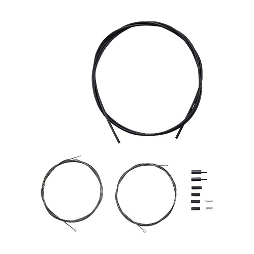

I am looking at these:

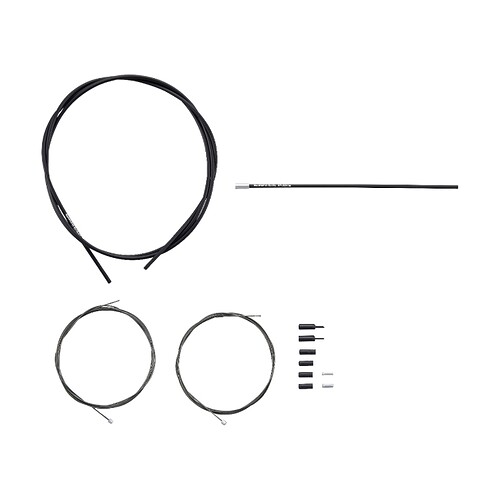

or this
the differences are subtle, but I don’t want to end up buying one and not being able to use it, or take advantage of the upgraded tech that appears to come with the OT-RS900 on my 5800 series

The only difference I see is one comes with a short chunk of cable housing specifically for the rear derailleur and the other doesn’t. Both look like they’ll do the job. I can’t comment much on Shimano shift cables as all mine have jagwire cables in them because I can get them cheaper from my local shop.
The only helpful advice I can offer is pay close attention to how the cables route thru the derailleurs and into the pinch bolts as getting that routing wrong can sometimes cause shifting issues.

You want that bit for the rear derailleur. You can buy them separately though. As Sir_Alan stated, issues near the derailleur matter, and the wrong housing there impacts flex in ways that might matter. If the 5800 uses standard housing for that, then it doesn’t matter. Some use a thinner piece though with a shimano part number.
The first one comes with the OT-RS900 which is a slightly thinner, more flexible cable that runs the last section from the chain stay to the rear derailleur. I believe the more recent Shimano groups sets (r7000 onwards) advise this as it helps shifting. As it’s for a CX/gravel bike I would think the subtle improvement would be soon lost in the mud! Looking to use sealed end caps might be more worthwhile for your application.

My main concern is whether the gear shift cable set with the OT RS-900 would work on my bike as it says it’s designed for the R7000 series while I’ve got the 5800 in the bike.
Thanks to all who have responded so far. Also, cuz I took so long to make a decision, the deal I was looking at is now gone :man_facepalming:t3:
R7000 is an Optislick set so will work very well with any Shimano gruppo. The OT RS-900 is a short flexible housing used to make a tight bend at the RD if needed. It is not truly compressionless because it is spiral wound. However, since it’s short, it doesn’t present a problem. That said, for most setups with the usual RD loop, I’d stick with SP41.

agreed, if it the derailleur came with RS-900 it needs it to avoid stress there, if not I don’t know if RS-900 would still be ok, but with how sensitive derailleurs can be, I’d still with original equipment, which in many cases is standard housing. RS-900 might not even be the correct length in all cases (I can’t recall if it’s provided in excess lenght). I think the ones that use that have the barrel adjuster pointed upward (mine does), and possibly a shorter loop.
Of course buying a set with the RS-900 shouldn’t hurt so long as there’s enough excess housing to cut a loop from standard housing anyway, and surely there likely is. If a shop is installing it, they should know what to do I’d hope.
