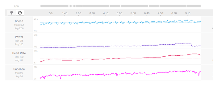

Has anyone else noticed odd but repetitive fluctuations / patterns in speed when looking at a Systm activity in Strava?
This is On Location Lake Chira from 31st May:
I’ve done it again this morning to complete the June challenge badge and the speed is, well, weird:
Zoom in and the speed is repeating the same patterns - other traces are pretty smooth

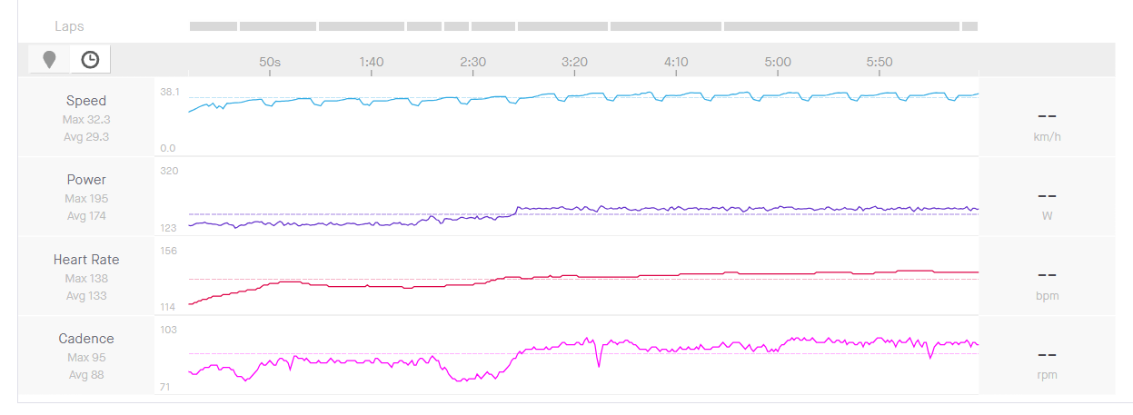

I also rode Spikes with The Boz this morning (the other June challenge I needed to finish) and that shows similar oscillations
Zoomed:
Power is steady as I’m in ERG mode (Saris H3 trainer).

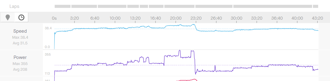

I also sync to Garmin Connect - this is the first five minutes or so of the speed for the Spikes workout:
Haven’t ridden inside for a while so haven’t noticed anything. But I was wondering, are you using “virtual speed”?
Unless the trainer sends speed information that’s what you have to use. Most smart trainers send speed information and use a 700x23 tire.
