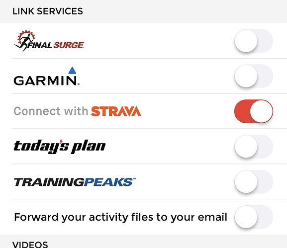

I’m a newbie! I’ve set up Sufferfest to connect to Strava but also need it to connect to my Garmin connect as that’s used for private medical points!
I’ve followed the same process as connecting for Strava and it tells me authentication is complete but it still says ‘connect’ rather than ‘connected’ and won’t send any historic riding data …

Sufferfest sends the data to Strava and I finally managed to get sufferfest to connect to Garmin connect. There was a lag in the interface for some reason.
