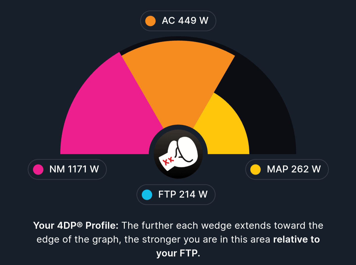

As a final follow up at the end of this plan, here are the results from my 2nd FF.
NM - 1171 W (+121 W) +11.5%
AC - 449 W (+43 W) +10.6%
MAP - 262 W (+57 W) +27.8%
FTP - 214 W (+44 W) +25.9%
Overall, very pleased with these increases. I peaked around 1400 W which was very surprising to see. I’m going to do the Mountainous Gran Fondo plan next since winter has officially started in the Rockies now.

Did your rider type change in the process?
No, I was classified as an attacker both times, but my MAP (pie?) section is larger than last time.
Before:
After:
