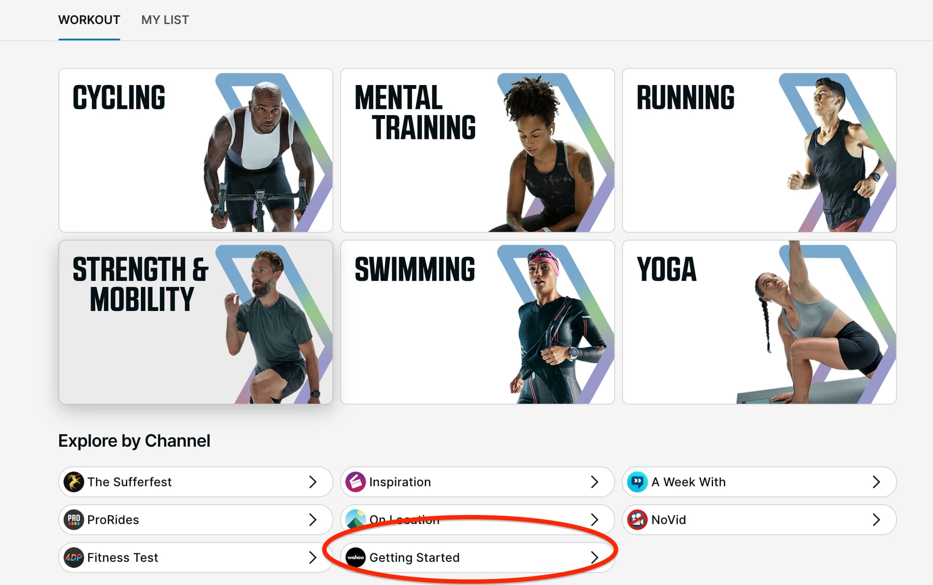

Edit: I’ll add that there are also about a dozen pretty good intro videos in the SYSTM app library itself:
