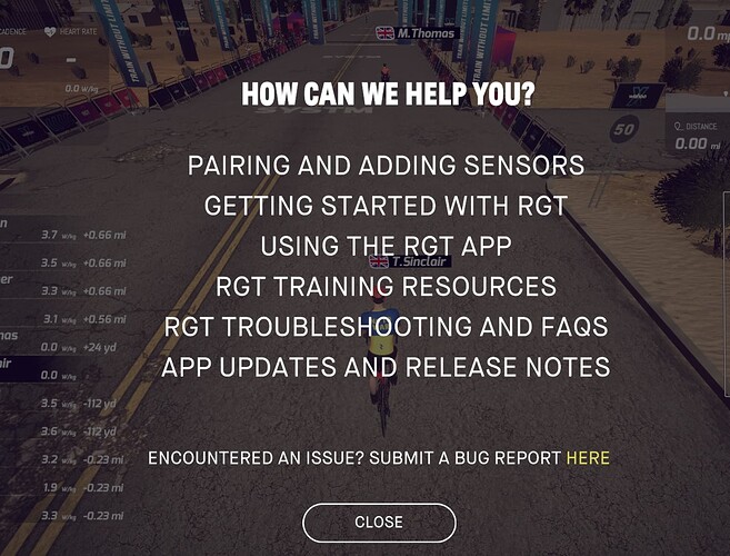

I had the same questions as these when I first started using RGT. It could be useful for them to display a help overlay in the ride screen that can be toggled on/off (like you can with Riders List / Segments etc.), that explains this kind of thing.

Yeah I was just thinking of a help overlay that you could easily toggle on/off that explained the basics of why your power number turns red and the colour bar indicator etc…
Guided tour on first load would be good as well - they could include onboarding for connecting sensors, changing the graphics quality etc. as part of that.
The in ride HELP menu links to much of the help discussed. I can’t seem to access the jira link https://roadgrandtours.atlassian.net but have requested access. This needs sorting out at Wahoofitness.com though
That’s a great idea. In some screens there is a ‘?’ at the top right and when you click on it it highlights certain features with explanations but it’s not available in the ride screen
