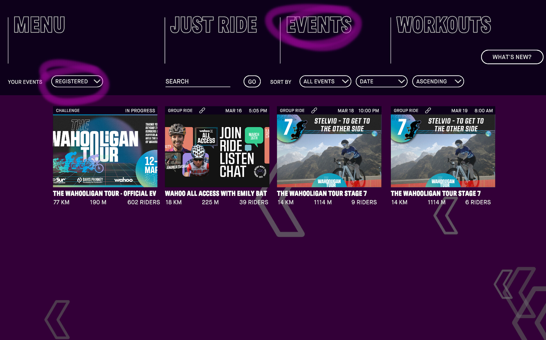

Option 1. Join a group ride.
Click on any of the links @DameLisa posted above, choosing one that suits your ride time. You will get an email to say that you’ve registered for the ride. Log into RGT, choose EVENTS, from the pull down list YOUR EVENTS select REGISTERED. Click on the card, and choose RIDE NOW. If the ride is supposed to start soon, then you will see yourself lined up with a countdown timer. At the start time, start pedalling, and you’re off. You won’t line up if there are still hours to go.
Option 2. Ride it by yourself, any time during the 50hr window.
Log into RGT. Choose WORKOUTS, search for ‘To get to the other side’ (or even just ‘to’), from the TRAIN ON drop down list select Stelvio, then click on the card for TGTTOS. You’re good to go.
Here are some screenshot to illustrate DameLisas an Natasha.Rs comments.
It took me a while to figure it out…

OK, looks like I signed up for an event for Friday 6pm (I hope it is using my time zone)
Do I still follow the screenshots to pick Stelvio? Or will the event alone work?
