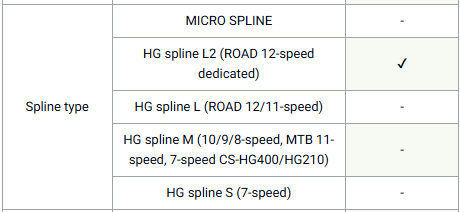

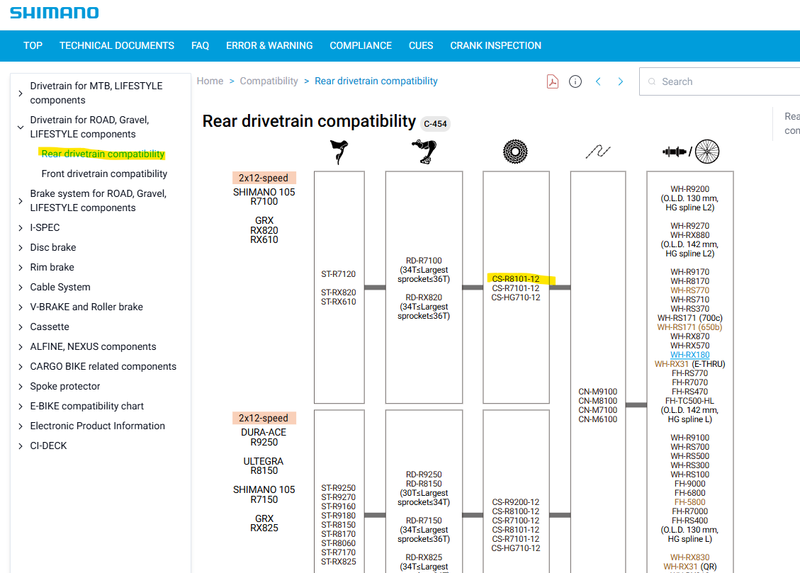

Hello,
I have this table from the official Shimano Homepage:
https://productinfo.shimano.com/en/compatibility/C-454
Please see this screenshot! Here you can find it.
Where do you have the information from, that it is backward compatible?
