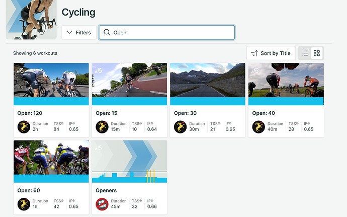

I am looking to create a long steady climb with no undulations for intervals — I don’t favor erg function. Is it possible to create such a course in SYSTM?
Bill Black
You can’t actually create a “course” in SYSTM. It’s not built that way. If you want to ride to a video that has no power changes there are Open Rides from 15 minutes to 120 minutes. Just search Open in the Cycling Library.
If you pick an open ride, just ratchet up the power to the desired intensity.
Yeah and then set the level such that you can keep the cadence you want at the power you want, and you’re good to go
