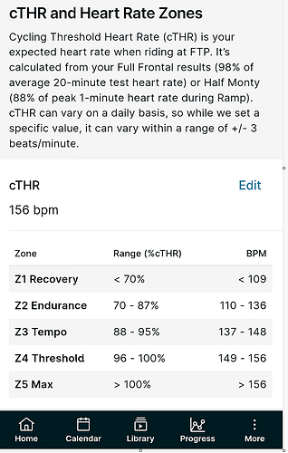

Hi. What is SYSTM holding for your cTHR in the app
(On iOS - settings, profile, athlete profile).
If that’s not been updated properly by SYSTM after your test it might need set manually.
My cTHR is around 92% of my maximum recorded HR in the last 2 years if that’s a useful reference
Hope that helps.

Hey there. Yeah that looks fine.
So if you’re in Z5 intervals you’ll see 156-something high I guess.

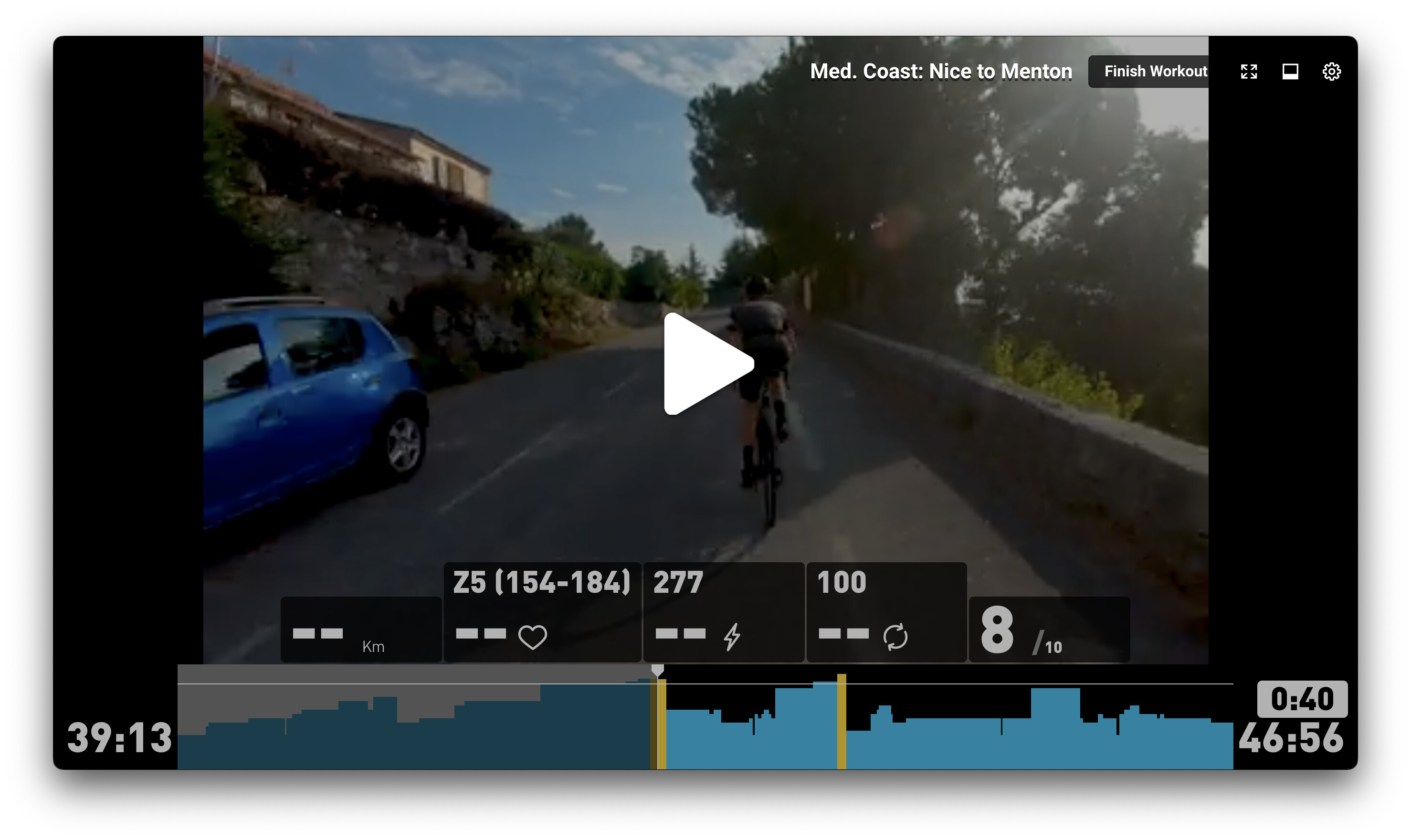

Here’s my HR zones:
And a screenshot from a Z5 effort in a workout I just recently did.
My guess is that Z5 is set as minimum = cTHR, maximum = cTHR + 30. I ignore the maximum value as there’s no way I can reach that.
As Sir @Martin said, check the device you’re doing the workout on and make sure it’s got the right numbers. They should normally sync automatically, but it’s worth checking.
Also, the HR numbers are a guesstimate on where your HR SHOULD BE. If it is lower, don’t fret it. You could be having a great day. If it is over, you need to take a recovery day. You are reaching overtraining. As to the science behind the numbers, there was a post on the old Sufferfest site on how Sir Neal came to these numbers. Coggins, et. al. did a long study on cTHR and the relationship to Power levels. However, it’s long, technical, and extremely boring for most people and really doesn’t get you to the point where you understand where the numbers on the screen come from anyway.
