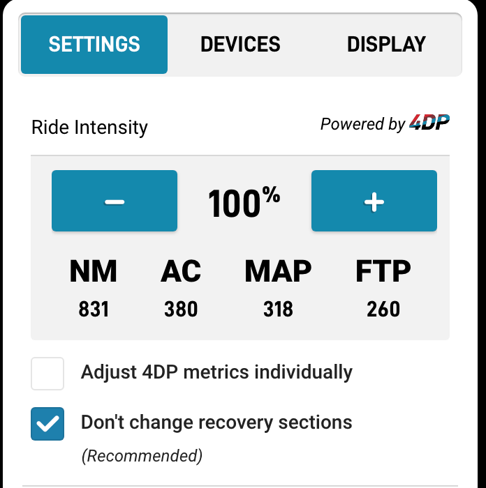

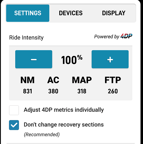

You can increase the targets in a workout using the up/down arrow keys if you’re using a computer with a keyboard, or via the Gear Icon → Settings section:
Adjusting the workout in that way can be a workaround until you get a chance to do another test. Half Monty is a good way of getting a reality check on the results from Full Frontal; Half Monty is less dependent on pacing.
I feel like the power target wattage is too low. Can you override that above the 100% some way ? Should I do the workout in Level Mode? Does that lift the trainer from automatically limiting to not go above my ftp if in fact my understanding is correct in that is how it works. I was going to redo the Full but try the half tomorrow instead as you suggested. Thanks!
Kickr Core is my trainer.
Hi Jen…Yes you can adjust the above to go over 100% if you want to, as mentioned you can adjust them all by a % or each one individually. Each workout is based on your FF results and as you go along in the workout in ERG your trainer will adjust the power requirements automatically, even if you never change your cadence (cadence itself is not controlled by ERG), some trainers take a few seconds longer than others to make the change up or down. If you do adjust say your FTP for example up to 120% to make the workout harder then the trainer will automatically adjust the FTP parts of the workout up to a % of that amount of power for that part of the workout. If you adjusted everything then all parts of the workout will increase by that amount. Again this will only work automatically in ERG mode. In level/slope mode the power targets are shown but the actual power you put out is totally down to you in other words, this is the same as outside where you control the power and cadence to go faster or slower so indoors its up to you to follow the workout targets therefore you can go over or under the targets freely. One extra help whilst riding where you can change things on the fly. If you are using a windows PC (not sure about a MAC) In ERG mode the up arrow and down arrow will increase or decrease the power level (all ) by 1% each key press, to go to level mode press the 1 key, you are now out of ERG mode and to go back to ERG press the ’ key(on my keyboard is the same key as the @). hope this helps and hasn’t confused you too much… good luck and welcome to the forum
