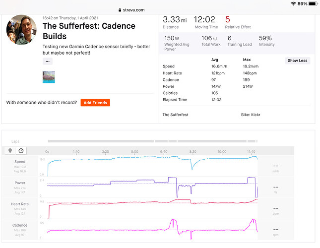

I bought a garmin cadence sensor this week and just quickly tried it out today. Seems better than the wahoo at higher cadences. It was good up to 199 rpm and then seemed to drop out just like the Wahoo.
I checked the Strava chart of the workout and as you can see cadence peaks, drops off sharply and picks up again for both the builds I tried today.
So suf support was right about the Garmin limits I guess !
