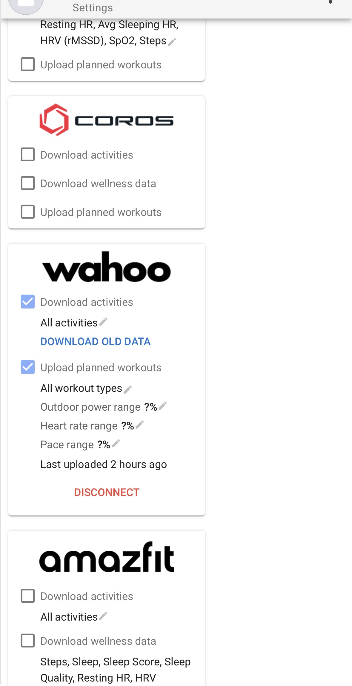

Are you looking to create your own structured workouts? ‘Routes’ would be outdoor rides, but you did mention you would be riding on a Kickr. If you would like to build a custom workout on intervals and sync it with Wahoo, this is how you do it. First link your wahoo account under settings → connections:

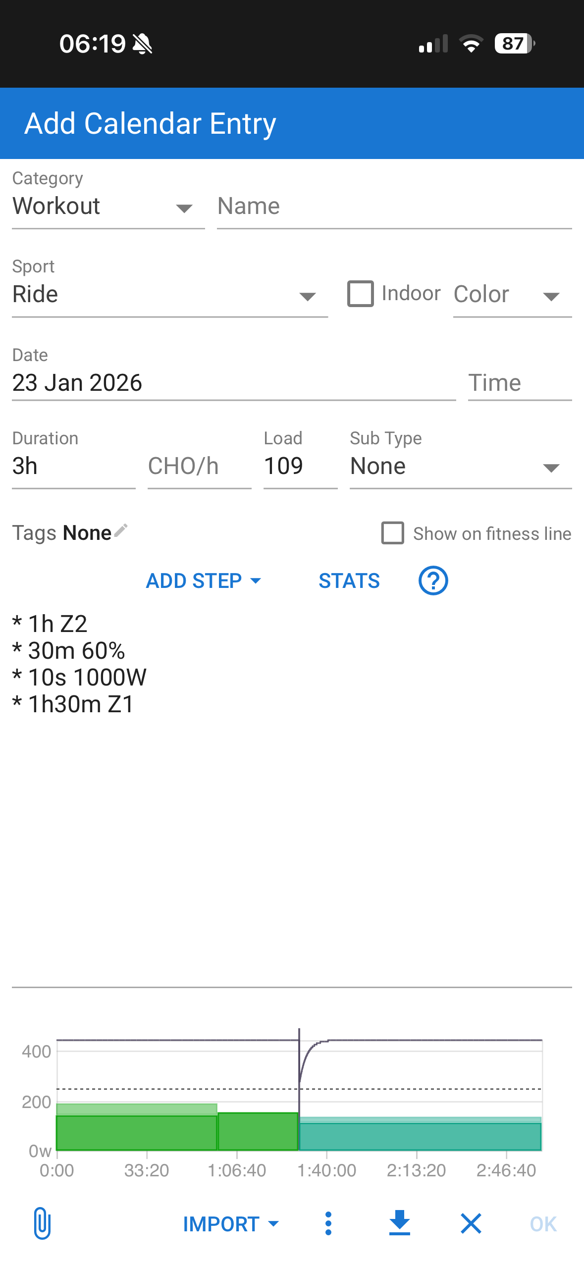

Then click a field in the calendar and select bike ride. In the screen that pops up you can plan your workout:
These will sync to the Wahoo app and ELEMNT after saving. There you can start them in an outdoor ride or a ride on your KICKR.

Just authorize the connection in settings and the workouts appear under the Planned tab automatically
