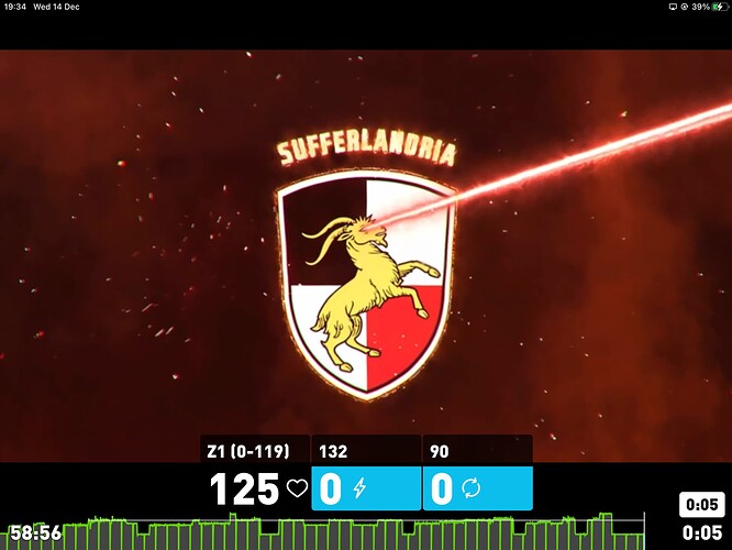

Installed the new firmware 3.0 on Tuesday evening. Oh dear what have they done, trainer maintains Erg but stops reporting power for 1-2 seconds every 56s. I noticed this on the first workout I did, then paid real close attention last night and took this screenshot during my workout because the dropout of 1-2 sec was too short to show in the workout overview from the day before. I’ve contacted JetBlack and looking forward to seeing what they have to say.

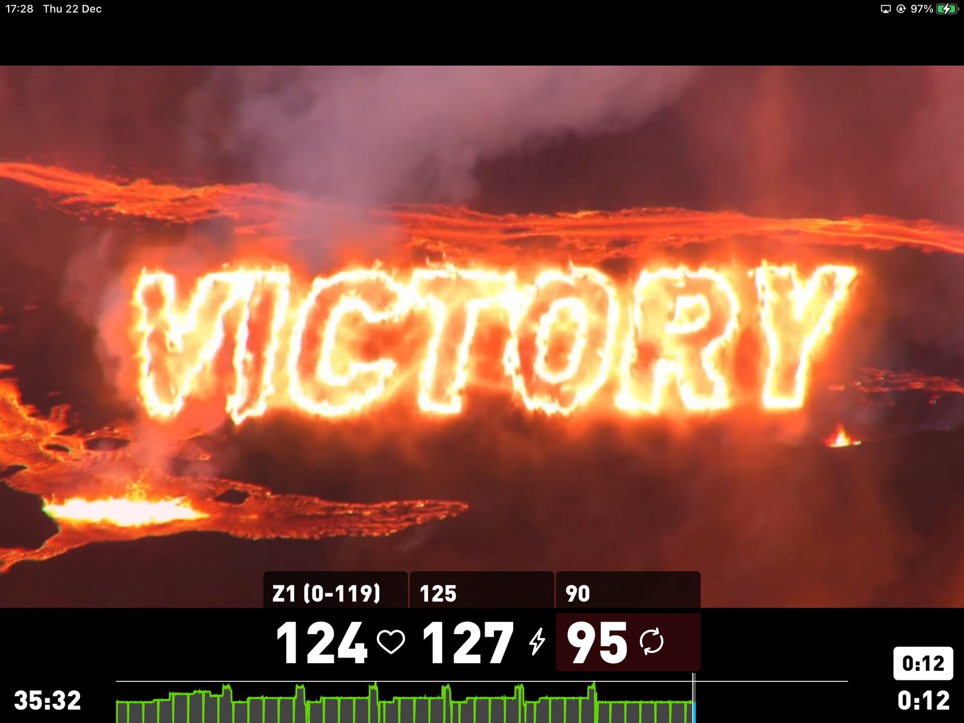

The regular nature of the dropouts is clear on the power graph below
