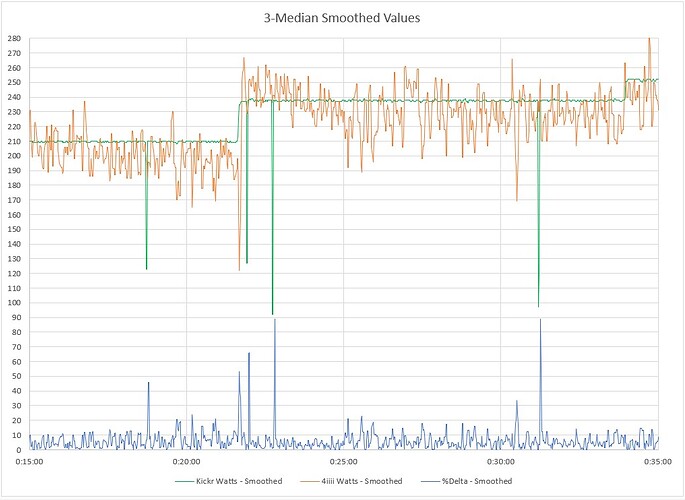

I took both .fit files & put them into Excel, & used a 3-median smoothing & the plot below is what I get. The output of the Kickr is already smoothed & I believe the ELEMNT is raw. I also show the % difference which shows it generally about 5% different.
When I look at the values, the 4iiii PM is reading an average of 6.5W low, but I think that difference is pretty clearly explained by my 5%-7% imbalance favoring my right leg.
Ultimately, if you have your ELEMNT running simultaneous while riding the KICKR, your values should be pretty close if everything is calibrated & setup properly.
