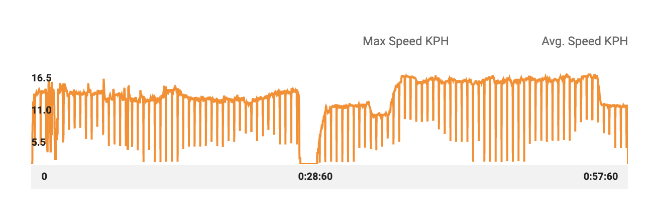

I just completed a half monty test and during the resistance mode sequence, I felt some regular short changes in the resistance. I did not feel that in erg mod
I just saw my speed graph and there are speed drops all along the workout, even in erg mode.
(I see the same thing on the Garmin Connect graph)
I looked into my past workouts and found I had a lot more like this.
Examples:
Igniter the 13th, OK, the 14th, lots of speed drops (erg mode)
Cadence builds, ok the the 14th, drops on the 28th
The 1st November I did To Get To The Other Side in erg mode, and the speed graph is totally smooth.
the 31th, I did the Hunted: drops.
I don’t see major drops on the power graph of half monty in level mode, but when I compare to the 4DP graph where the speed graph is smooth, the power output is way more smooth, so I think there is an impact on the power output.
I zwifted 3 times last week and no drops. No drops either in my previous Rouvy & Tacx rides.
I’m using the Tacx Neo 2T smart, I did a firmware upgrade around the 20th, so it is not related as I saw the issue the 14th.
Maybe a bluetooth issue ? but my setup is always the same.

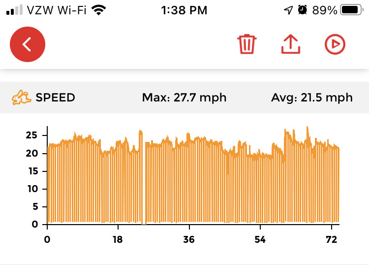

Thanks Arthur. I have had success with the suffer speed setting, but I feel like this is not a true resolution to the problem. It may be a Tacx issue in your case, and it may very well be a Kickr issue in my case. The speed drops occur when I use bluetooth, and the Kickr speed. I have also tried a Ant+ dongle and get a whole new set of issues on top of the speed drops. When using Ant+ the distance measurements are way off. For example, I did Attacker and averaged 21.8 mph. The distance on the screen at the end of the 53 minute workout was only around 12 miles. When I finished and saved the workout it showed 16.9 miles. If you do the math, that doesn’t make sense either way.
