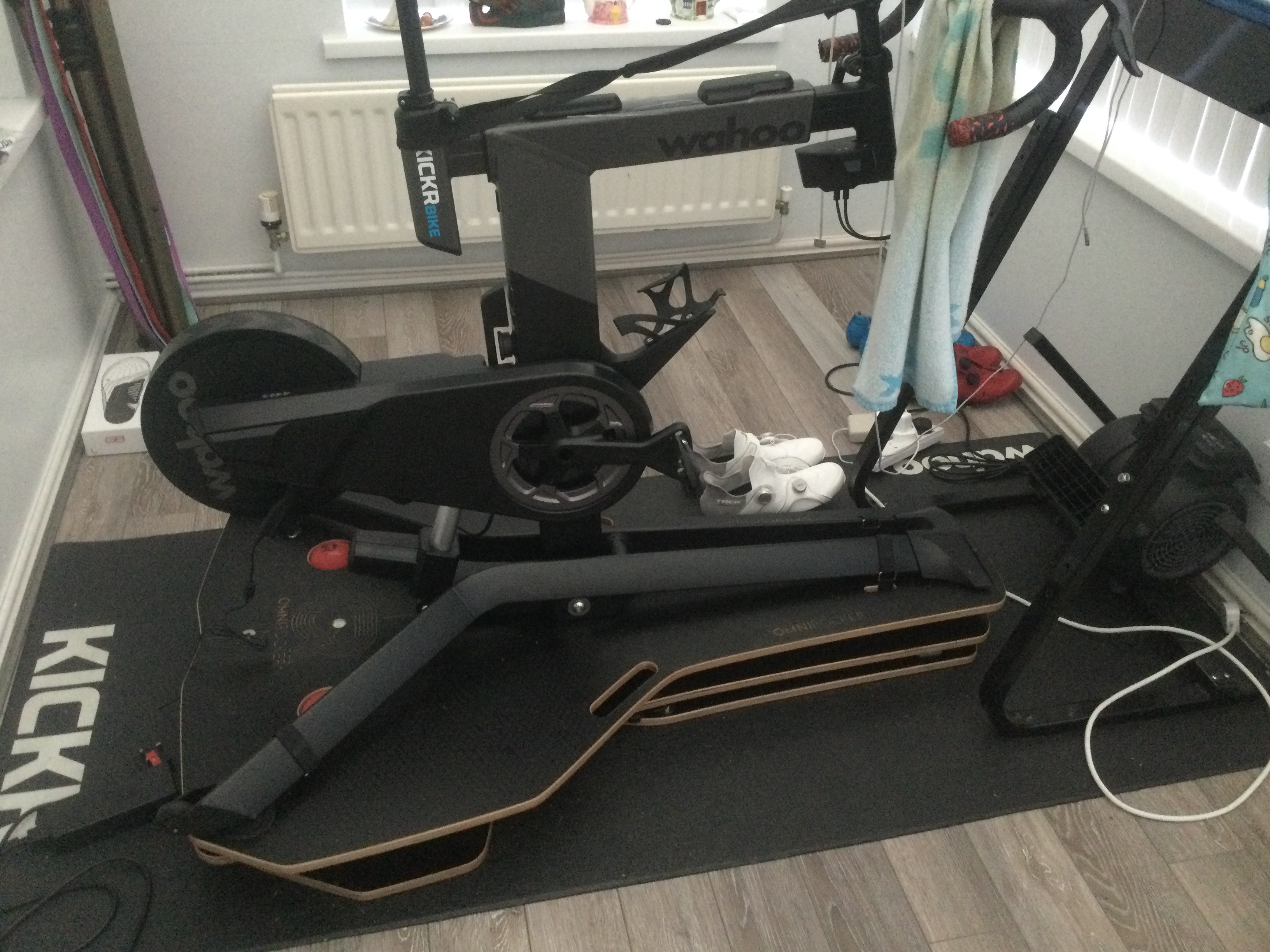

Hi Robert, I used to have a Tacx Neo and got the Saris MP1 Rockerplate unfortunately I found it very bulky, awkward and definitely a 2 person job to move around. Last year I bought a Kickr Bike and looked around for something else, I came across a guy who builds them specifically https://omnirocker.com but unfortunately this is really for people based in the Uk if you live elsewhere it might not be applicable. It’s a much more compact and enjoyable experience certainly easier to move and setup as well as it comes fully built, only thing needed is to pump up the balloons. Whereas the Saris and other Rockerplate are sometimes a 1 Size fits all, he makes 3 for a Kickr Bike, for a bike and trainer and for a Wattbike Atom
