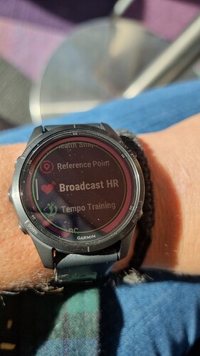

My Garmin Fenix picks up my Wahoo trainer with no issues. Hubby has a Forerunner 900 series of some description at home I will confirm if it can also see my Wahoo trainer.
And finally, you can do HR broadcast off most Garmins, it is an extra “workout” type you need to install, see photo below:
More food for thought, thanks.
I know the Fenix has a few features that the 935 does not, and looking through the workout options to add, HR Broadcast isn’t one of them. Perhaps it is on the more recent 945.
