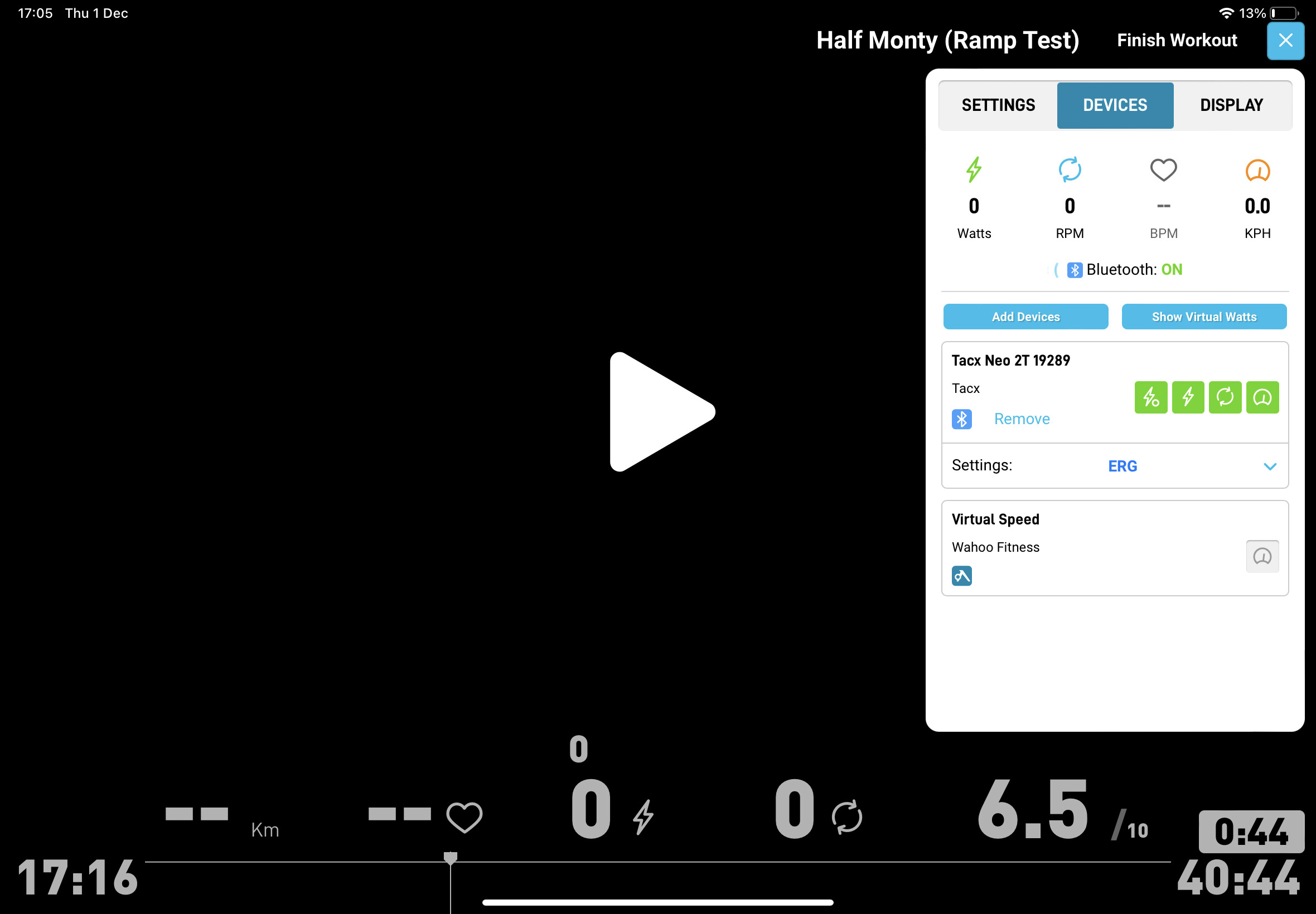

I’m having an issue with Half Monty. It’s a ramp test, but doesn’t show the graph on the iPad SYSTM app, so basically I’ve got no real idea of what’s going on. Coupled to that, it isn’t controlling my Tacx Neo 2T, so it’s basically just acting like a big screen bike computer… I’m new here, so I’m assuming there some setup I may have missed?

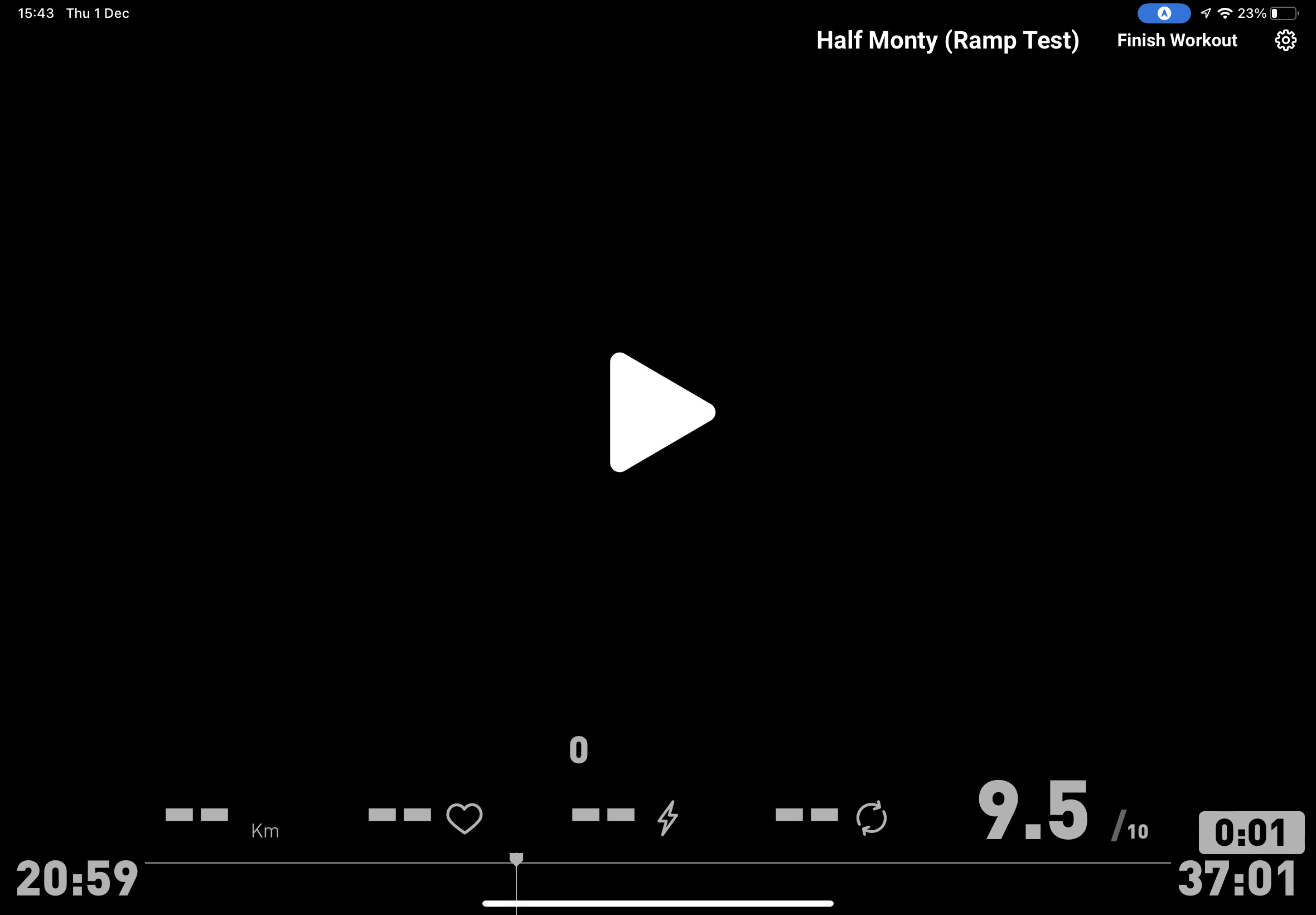

Doesn’t show graph on the MacOS app either, in any bike workout.
Not sure this is for me. The words in Half Monty are talking about seeing a big block of yellow steps - great, except they aren’t displayed.
Here’s the screenshot from the iPad. Doesn’t seem to control the Tacx Neo 2T, although it does sometimes when there’s a power target above the power field. There was no power target for the steps, so I guess this is not working properly. Another thirty minutes wasted trying to get it to work, and about ready to delete the app.

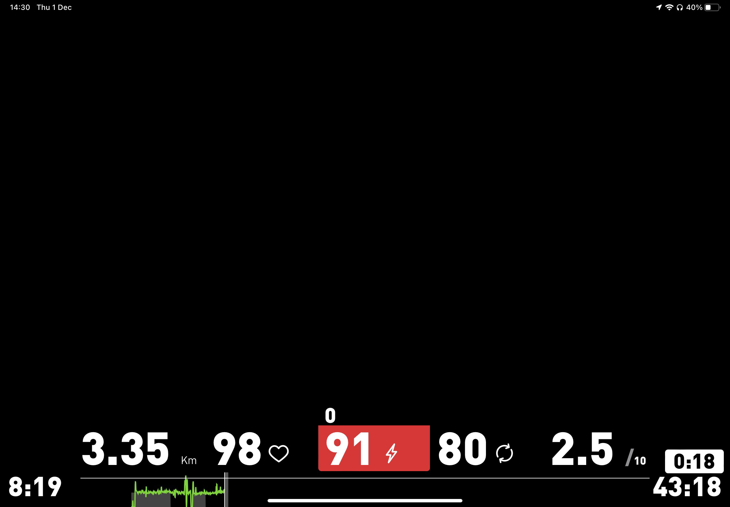

Just done a new install of the app, no devices connected, but just checking the half monty, and still no graph displayed. I’m ready to throw in the towel and cancel my trial; I’ve seen enough.

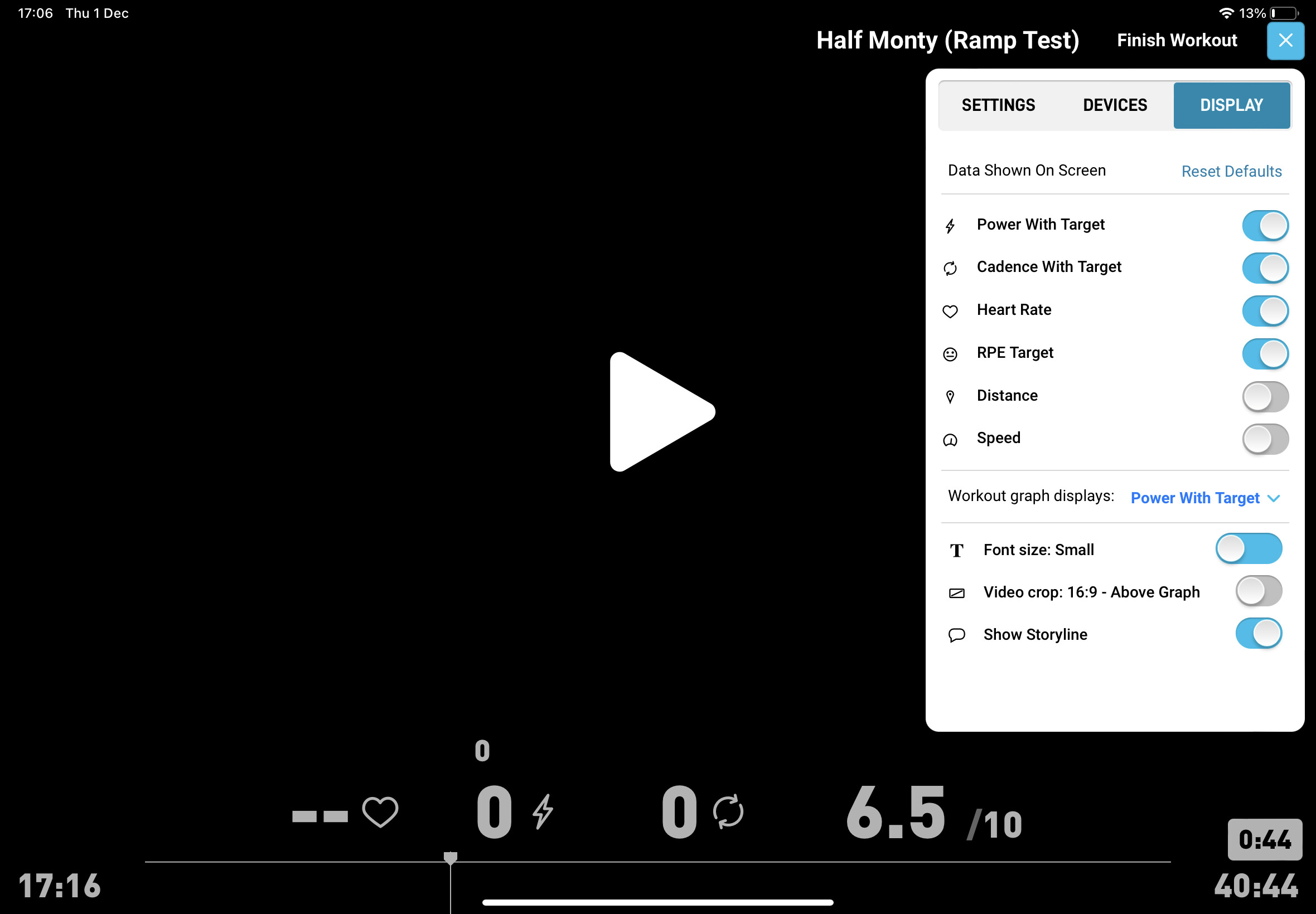

Seems odd. Have you checked the display settings? Both that it’s set to display power with target and that cropping above the graph is off?

Yes, I tried those options. Shifting between power with target, and cadence/hr takes away the thin grey line, and on cadence there were two red columns appearing from the bottom - I suspect the columns are off the bottom of the screen.
Still no control of the Neo during the steps, even though the smart trainer control icon is green.

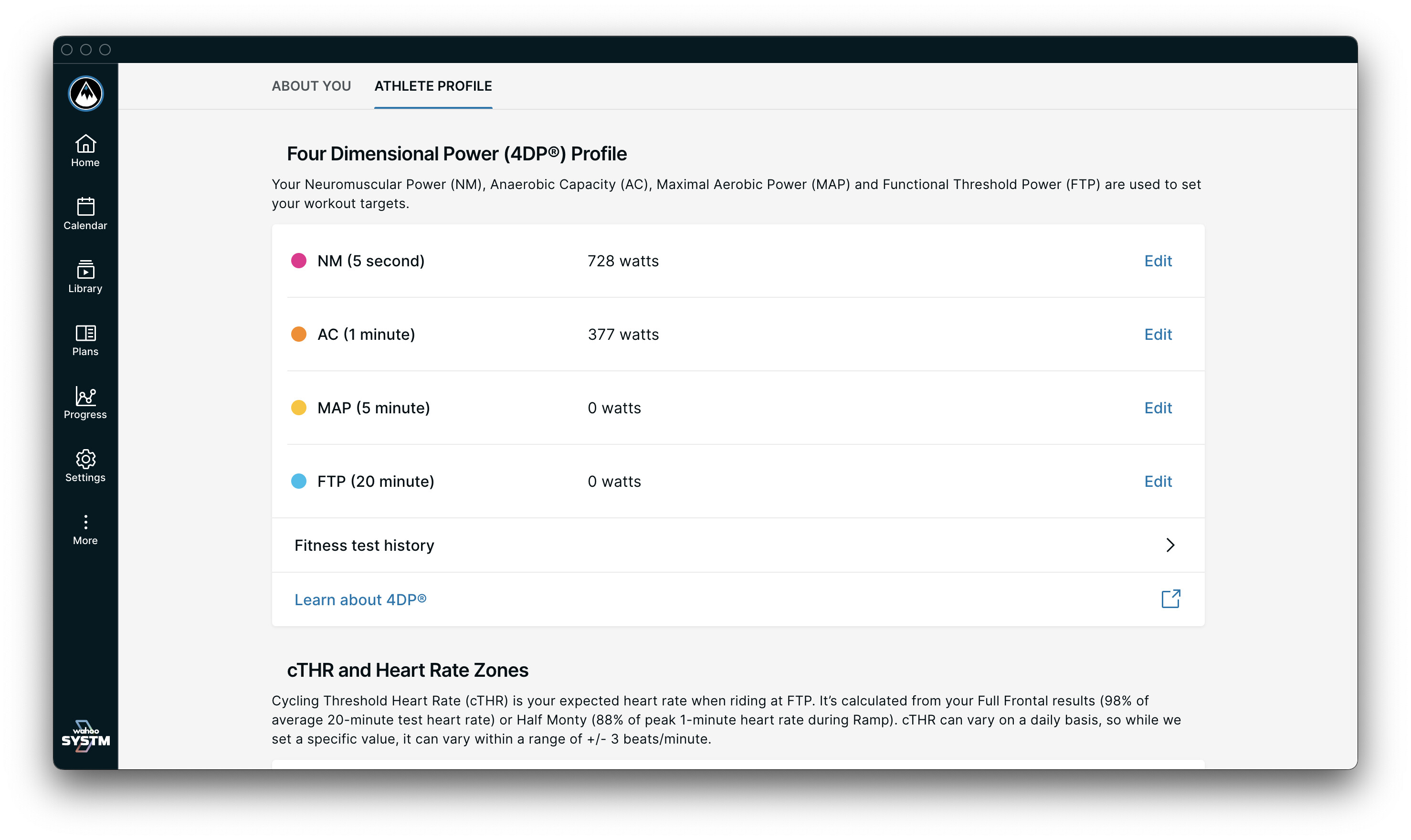

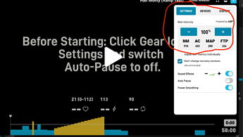

Hey @Dan_Carr, is it possible that in your Athlete Profile there are no numbers set there for an estimated NM, AC, FTP and MAP. You’ll see that in the settings tab when the workout is open or in the athlete profile when you are not in the workout player:
see pics:

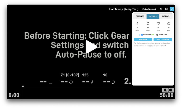

when in workout:
When in main app:
Edit: I’m almost willing to bet this is the case cuz I can replicate your lack of graphs when I edit my numbers to 0.
Edit 2: you’ll need some numbers in there and you can edit them in/from the Athlete Profile. From settings in a workout all you can do is adjust the intensity from the numbers that are taken from the profile for that particular workout

I think the app normally puts in default values for FTP, MAP etc. if you’re a new user. From memory, FTP starts at 150 W.
As @Glen.Coutts says, and I can confirm, manually adjusting my FTP and MAP numbers to zero in my Athlete Profile (accessed via the top-left icon on the app screen) removes the power profile from within HM.
If you’re still not having any luck, can you post a screenshot of your Athlete Profile?
I thought new users were given a baseline set of data prior to testing which I why I thought it was odd that you had no graph at all. The only way I could replicate was to essentially cancel my own profile numbers.
