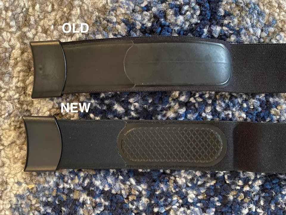

I only had problems with my TICKR v2 since the first strap probably was flawed because they changed it. Either the HR froze, was 0 or roughly double my HR.
Top is the first problematic TICKR v2 Strap and below the new and improved one:
Wahoo had a superb support and changed the TICKR three times but only the third one with the new strap solved my problems.
