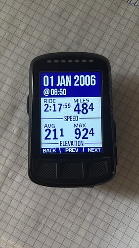

I did a 50 mile TT yesterday (17/08) with my Bolt v1, a separate warm up, stopped the warm up then started 5 seconds before the off. All data showing on both rides, also pressing lap multiple times for splits. After finishing, was close enough to my phone for syncing. A little later, trying to find the data on my phone, nowhere to be seen. Tried to sync again but nothing!
This is what I found on the Bolt.. data was wrong! Time I did notice was GMT and not BST.
Also, elevation and maps greyed out in the app but showing on the Bolt.
The also weird thing is that the Bolt wasn’t born until 2017🤷🏼‍♂️
I won’t know my time until it is printed on the CTT website now. Here in the UK
