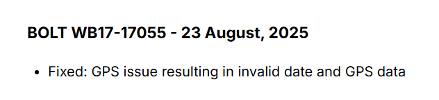

Just noticed this on the firmware releases page:

Did the firmware update earlier and just been out for a couple of hours and can report it’s working perfectly again on my Bolt V1. :+1:
Downloaded the firmware update on my Element Bolt 1. Went around the block and seems to be working fine now. Need to do a longer ride to be sure. Thanks for sorting Wahoo.
