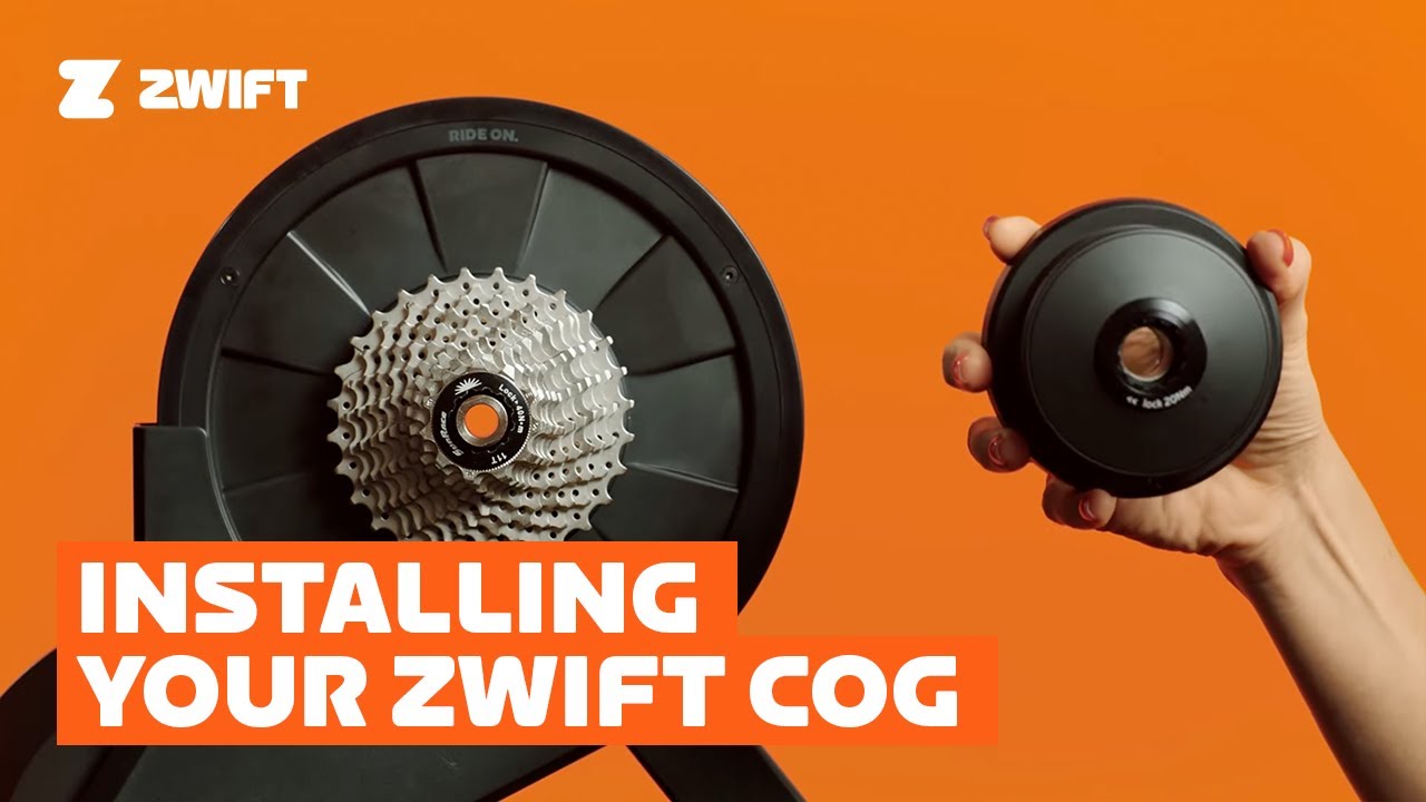

Sorry for all of this you’re struggling with, @beleroy, very frustrating for you, I’m sure. I will say that swapping out the cog for a regular cassette is fairly simple, and usually only requires a wrench and a cassette tool (which are specific to brand and cassette size, but not that expensive.) - maybe a chain whip. No more than $20-30 US would give you all you need.
There are any number of youtube videos or instructions on how to swap a cog and cassette - many from Zwift specifically:
Just imagine this, but in reverse.
Wish you the best, and hope you get things sorted out soon to your liking so you can hit the (virtual) road.

So, what you say is that I keep my kickr core and just swap the cog with a cassette? Didn’t imagine it was possible 
I will do that tomorrow and I will give feedback after I have used it.
