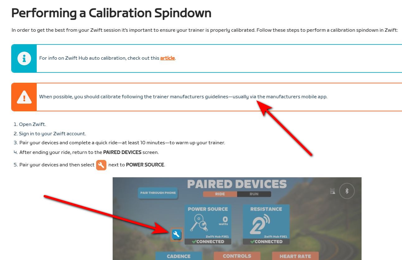

I don’t know. But, when I had a Snap, I would always calibrate using the wahoo fitness app. Even Zwift recommends using the manufacturer’s mobile app
https://support.zwift.com/performing-a-calibration-spindown-ByUaXPoi9
Please open the link you provided

My point in sharing the link was to bring to your attention that while you can calibrate your trainer in Zwift, even Zwift is recommending you don’t.
