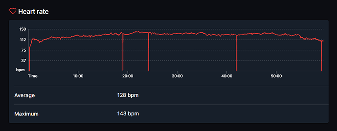

Is this a known bug ? When I upload my training to strava, the heart rate is weird.
I did 2 trainings with Wahoo SYSTM and this is the same for both trainings.
Thanks
Strava
Systm

@MaxT Definitely looks odd - probably interference or something. Maybe put in a ticket with the minions.

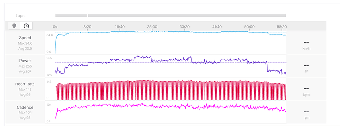

Have exactly the same issue with the new app. On the old one works fine. So is not an interference but something related to software…
On SYSTM, heart rate looks fine. When it syncs with strava, the issue appears.
When I upload the fit file on strava and on Xert, there is an issue.
Everything seems fine when I upload the TCX file.
Some of my workout sync correctly, but the majority have issue.

I too have exactly this issue. When I “zoom in” using Analyse on Strava, it looks like it’s recorded two data points correctly, then one zero, and repeats that pattern over and over.
This first started happening to me about a week before the SF->System switch over…

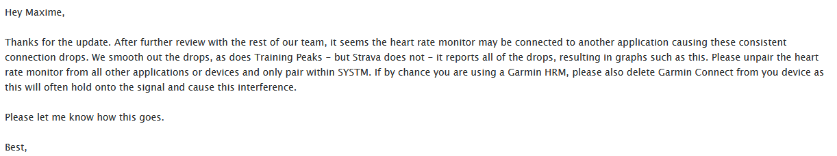

I just had a response from Wahoo as follows (and kudos to them for the prompt, personalised and genuine reply):

Yeah it’s not an issue with Strava - it’s an issue with SYSTM and bluetooth sensors. It just shows up on Strava due to how the data is charted. See my post above where I quote a response from Wahoo. They say it’ll be fixed…
