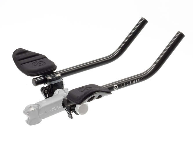

I guess one of the annoying time-travellers answers would be get a pair of the quick release aero-bars, so you can just clip them on and off as you please. Failing temporal assistance, would loosening the aero-bars and rotating them down/moved inboard out of the way, on the bar, help at all ? (if you haven’t already tried that)
With a few alignment markers added to the risers and bar, it should be reasonably quick to do so.
Unfortunately she wants to hold where the bars are attached to so the clamp will still be there with dropping them down.
I didn’t know there were quick release ones, I’ll have a look for some of those.
Redshift Sport do some, although they’re inevitably not cheap, and you would still be left with the tiny, flat stubs next to the stem - which might still be an issue.

I thought I remembered a couple of other QR bars that i’d seen on bikepacking rigs, but can’t seem to find then at the moment, will have a dig later…
Pricey but nice. I’ll see how much Wahoo want to charge me for a second official frontend and compare the two.
