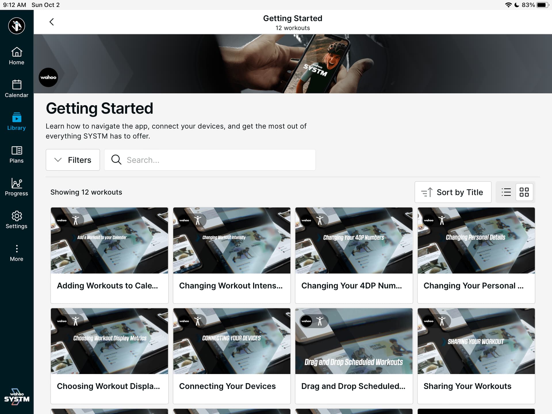

Also note that there are tutorial videos in the app in the getting started channel that might be helpful to you.
