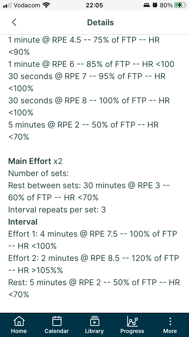

@Dan, I would caution about simply leaving âCadence in the shadowsâ for outdoor workouts. During the warmer outdoor training season, my workouts come prescribed with both power and cadence targets, and I am looking for compliance in both. Depending on the athleteâs goals and what they are training for, having the ability to not only increase and decrease power output, but also the cadence is important. Long climbs require the ability bear down and handle the slog of lower cadence and higher power output efforts. For punchier scenarios like Criterium racing, rapid successions of high power and high cadence efforts are certainly advantageous. Strong power and cadence flexibility is an indication of a strong athlete with deep capabilities.,

Okay, then why do the suggested no-vid workouts that can be done outside not contain a target Cadence along with RPE, Power and HR targets? Hence why I said Cadence in the shadows as it doesnât even feature in your own literature. My emphasis was based on what you state in your own literature. This context of my comment matters.
If what you say is imperative to the student, surely your literature should include the important bits to completing a workout as desired by what you state.
I am not saying cadence is to be forgotten, and it is contextual to building muscular endurance to work in the high and low cadence targets in differing power ranges, but that would be a specific workout set out for that.
However, when a person is looking for a hierarchy list of what he considers important and what isnât, and what they should focus on, I used the Cadence in the shadows comment, in the context that it doesnât feature to his focus.
Picking the first workout that came to mind about our comments above, I donât see your important Cadence target being stated. I am sure all the suggested outdoor workouts will be lacking the Cadence target.
Does one make the inference that the mere folk who do not make use of the personal coaching are being short changed by not being given the full information from this training platform when applying suggested outdoor workouts? No is my answer as context matters.
I assume you will be including this said aspect to all workouts that can be performed outside to ensure that us students perform to your expectations and remain compliant?
If itâs that important to take my comment out of context, itâs that important to make sure itâs stated in the workouts.
