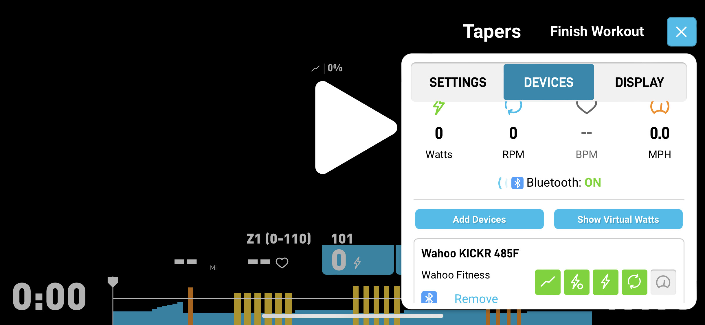

I’m not familiar with the brand, but suggest a few steps that might (or might not) help. If you’ve done all of this already, I’d send a ticket to customer support.
  1. Make sure nothing else is connected to the trainer. It should t be connected to your phone, tablet, or anything else.
  2. Start up SYSTM and go to the device tab in settings. Sounds like you’ve been there. Do you see you device listed? If you do, make sure the little icons that represent different sensor channels are green. If they’re gray, click them and they should switch to green. The screenshot below shows what green icons look like. (One is gray—the speed sensor—because I selected, as you should, the SYSTM speed sensor that you can’t see in my screenshot.) The lightning bolt with a circle and the plain lightning bolt are the most important. The one with a circle is the channel that controls your trainer in ERG mode (and makes it a smart trainer). The one without reads your power.
  3. If you don’t see your device listed (or it’s listed in a window to the side), you need to add it. Click Add Device then click the trainer in the window that pops up. Close the extra window and go to step 2.
Hope something in there helps. If not, good luck.
