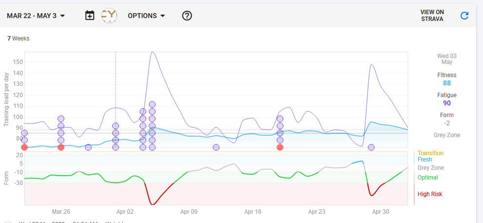

If you aren’t using the Fitness graph on Intervals.icu I highly recommend you check it out. I use it to monitor if I’m overdoing/under doing it.
Fitness chart
