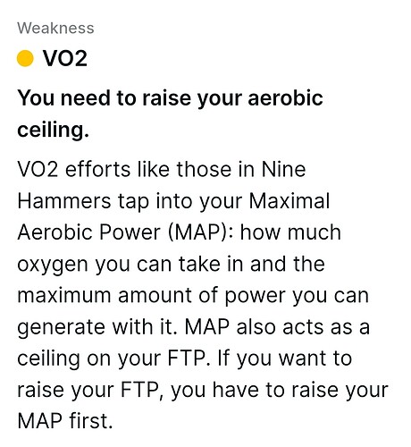

My 4DP profile says Im a climber (no news for me that always loved climbing and have a lightweight with my FTP around 4.2wkg).
I dont want to follow a plan on systm, at least while the plans are so rigid and have a lot of manual work to do to get it ok for the shedule I have. Adaptative training like TRoad has would be spetacular.
So my question is about what random workouts I should pick in the 2 or 3 days a week I workout in the trainer from tuesday to thursday (weekends are for large outdoor rides and mondays and fridays usualy I give it a rest or just a short recovery ride).
So far I’ve been picking one climbing and one mixed workout a week (tuesday and thursday) and an endurance ride or an RGT soft ride on wednesdays. Why?
Because my 4DP weekness is VO2 max and in mixed workouts theres some training to adress that and I still get better or at least dont loose my ability at climbs doing at least one specific workout for that every week.
Any thoughts on that? Tips to get better on VO2 max not loosing my FTP power are very much welcome.

@SSaldanha I believe that this methodology is still being followed in SYSTM from the Sufferfest days but one of the philosophies with Sufferfest was that if you improve your Aerobic ceiling, VO2 Max, you would also pull up your FTP as well since those work in a sort of tandem to each other.
I can tell you I have had the same weakness and worked on it for awhile and it recently changed to sustained power weakness. In the process of increasing my Aerobic abilities I would say my FTP has several incremental increases. It has gotten to a point where my FTP has not really risen but it has become easier to hit that threshold level and hold it for longer and repeatedly. So I would say VO2 work will only help you.
Also read up on VO2 and VO2max as these are two different things because believe you me VO2max workouts are brutal and doing one every week is hard.

  • weakness is a ‘term’ that just means a person producing ‘n’ watts for 20 minutes on average can often reach ‘y’ watts for 5 minutes in a given test scenario (4DP). Which is an incredibly useful pointer, but do remember it’s just a pointer :+1:
  • if we leave the above aside, I am a complete believer in the mantra that VO2 helps push everything else, so doing VO2 workouts will benefit your training. You’re not going to lose anything else as you’re doing your weekend stuff and I’m guessing they aren’t zone 1 rides :rofl:
